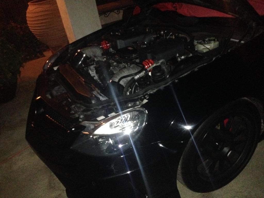

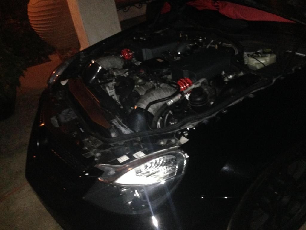

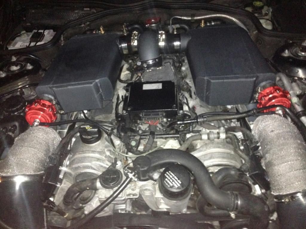

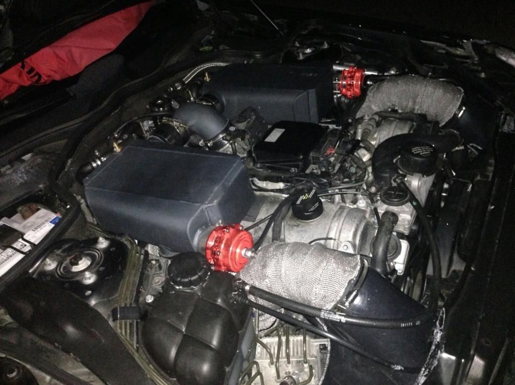

Here's my latest/last 1 off CAI piping to outside grill goes to nearly 5" DIA.. It's far and away best CAI I've come up w/ALL silicone tubing w/gradual decrease to puny stock turbo air inlets. Wrapped in graphite header wrap, except for last 5-6" exiting front grill.. Wheels are new lightweight CCW's 18x13 wrapped in NEW Toyo R888 335/30 breaks loose in all 5 gears 57 deg F tnite ;) MB tech chkd boost in Star Diag laptop again, while I drove hit 26-27 psi.. External BOV's sound insane, like fast spooling high pitched exotic
"DUAL ELEPHANT TRUNK" V12 BITURBO CAI

To expand on that, here is what I see- I'm not aware of how exactly MBZ manages their fuel trims, but it would occur to me that if under vacuum one of those does collapse, that particular bank is going to see the following: Choked air supply under heavy load (read: boost), AFR goes rich, O2's pick this up and compensate by dialing back fuel to keep stoich. As soon the car hits a shift point, boost drops, pressure bleeds off through the wastegates, and the collapsed tube regains form... all in a split second. Immediately, you're back in full boost in the next gear, and all of a sudden extremely lean in that bank as you've just reintroduced 27psi while the ecu is still only feeding fuel based on the short term trims sampled during that bank's rich condition.
Basically, in an instant, you'd go from say 12.5:1, down to a pig rich 7 or 8:1, then spike back up to 15 or 16:1.... which can and will detonate and kill a motor in a split second.
This isn't a guarantee, but its a legitimate risk that all makes mechanical sense in my head. I'm completely open to discussing that further if anybody knows more about Benz's ECU's.

M275 biturbo engines don't run peak boost full time, mines heavily modified. It hits 26-27 lbs for a couple sec @ 4500 rpm's then boost falls to high teens thru the remainder of band.. AFR's safe @ 12.3 only runs supreme or race fuel. Makes 633 whp 750 wtq on 91 CA pump.. Been safely running like this for 3+ years...
