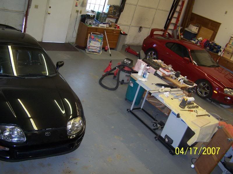

Back in '07 when I pulled the head to replace some valve seals:
