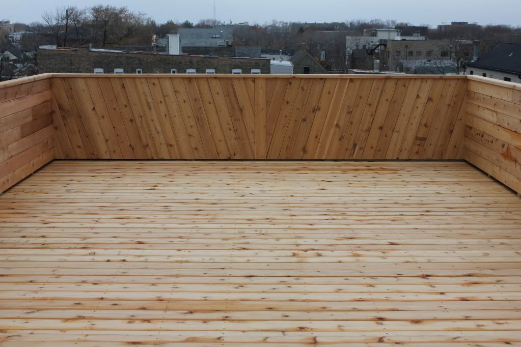

The deck itself is finished. We are super stoked with the way it came out!! We went with cedar because we really like the natural look and durability. Here are a few pics of the progress.

Here are a few more pics of the finished product. The last one is of a 10' x 18' section that I'm going to put down artificial grass on. Unfortunately, I was unable to get any before I head back south for the winter. I still have plans to build a pergola, an outdoor kitchen, along with a few other things this spring.

Thanks so much guys, I appreciate it!!! Slik560 is exactly right. They are cut up insulation panels. It makes for a perfect go-between barrier. It not only protects the roof but it's a great sound deadener as well.

Awesome!!! How the heck did you get all that lumber up?
No $h!t, that was my first thought too. . . lol. . . They used a crane truck to hoist it all up there.

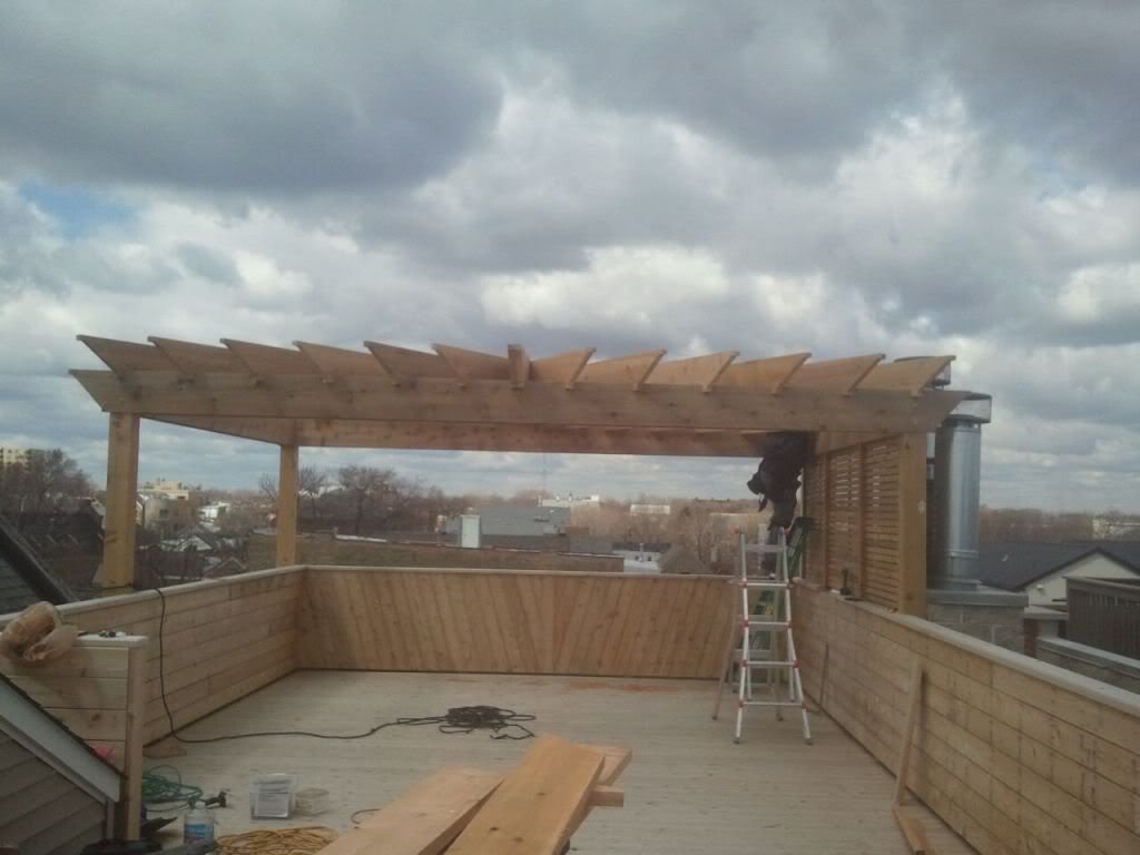

7
Here are a few pics I took last year after the pergola was finished and everything was stained. Since then, we've added a full on organic garden and of course, a WEBER ;-)
