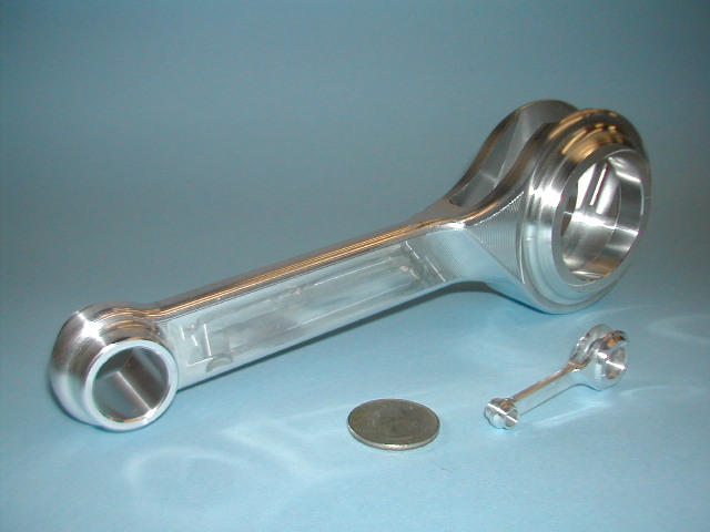

    The forked rod that is in the Munro Special and the quarter scale of the same.
