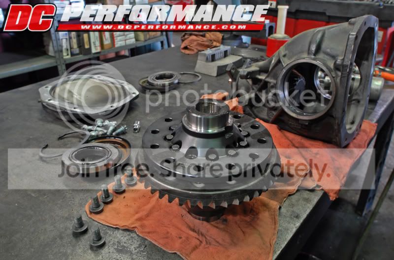

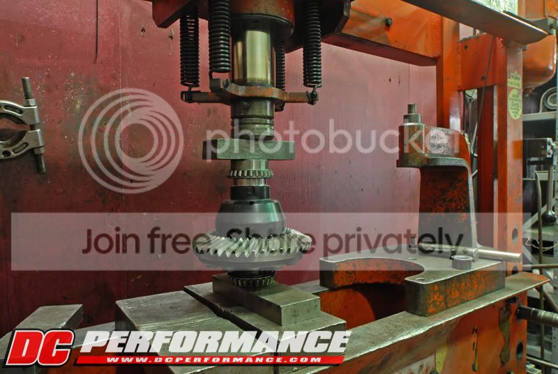

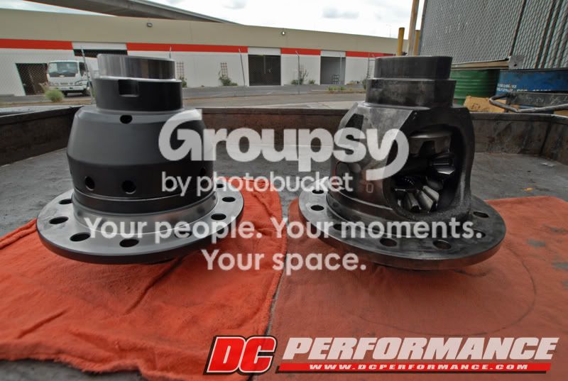

    I am the first and only w211 E55 at the moment to have the upgraded Wavetrac Differential... (I am offering introductory pricing, PM for details)
    Fits M215 rear ends
    I have driven 8,000+ miles with no issues...
    Less expensive and a better alternative to Quaife...
    The photos...
