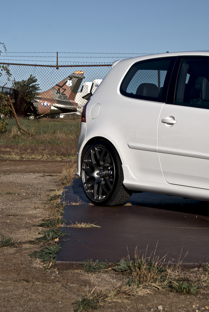

    I worked a deal with StopTech to use my car for the development of their BBK for that R platform, so I needed a set of wheels that would clear the big brakes:
    But, it looked silly being so high with those wheels so, I had to lower it:

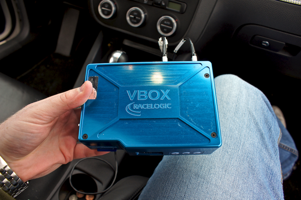

    Wired the car up with all kinds of measuring devices:
    Measured braking distances with the OEM brakes and then again with the Stoptechs. I don't remember the exact numbers at this point since it was so long ago, but over 10 high speed stops we shortened the stopping distance by some 10 to 15%.

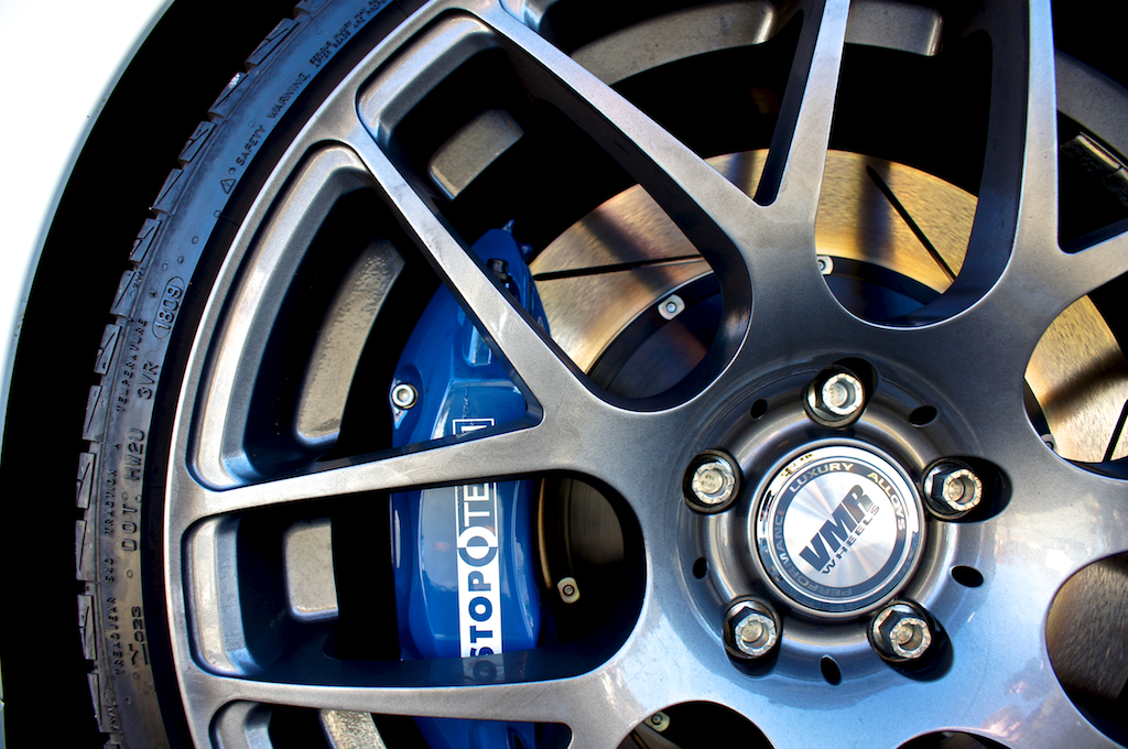

    Stoptechs vs OEM:
    Installed and tested:

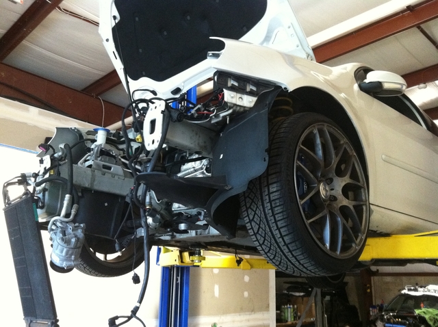

    For a while, that was good enough. But, as time went on I wanted more from the car. I wanted to drive the car with a proper 6-speed manual gearbox. I took the car down to Jeff @ UnitedMotorsport and Tom @ Innovative Motorsports and let them go to work.
    As the job went on, we talked about putting in a new motor, the 3.6L FSI VR6 motor. It had direct injection and made a ton more power and torque. So, we went for it. Little did we know what a nightmare that would turn out to be. Between removing the DSG harness and swapping out the wiring for the old ME7 ECU for the new ME9 ECU, there are about 450 hours worth of wiring into the car.
    Some of the build photos:
    It took about 9 months total to get everything together and working 100%. The motor and trans are happy in their new home. While the car was in the shop, I was continuously looking for other parts to add.

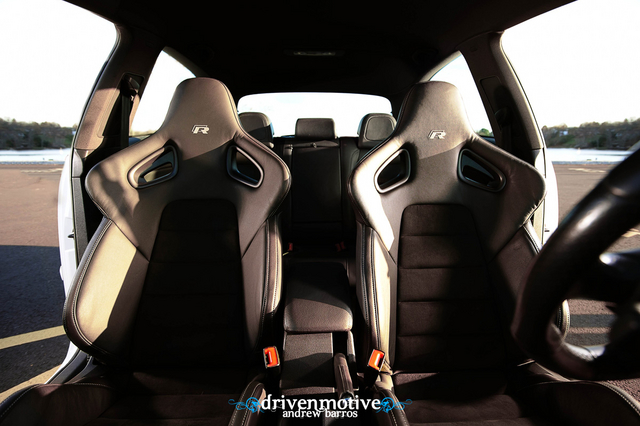

    Scored some European Motorsport seats:

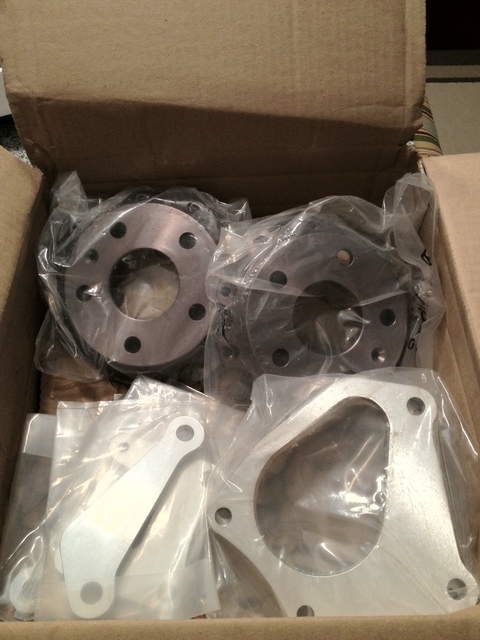

    Had some custom rotors and hats machined for the rear brakes:

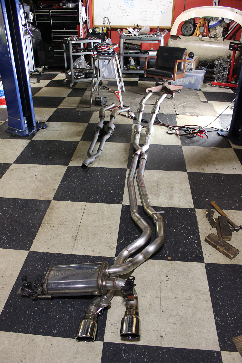

    Had a custom exhaust made:
    Video of the exhaust being tested:

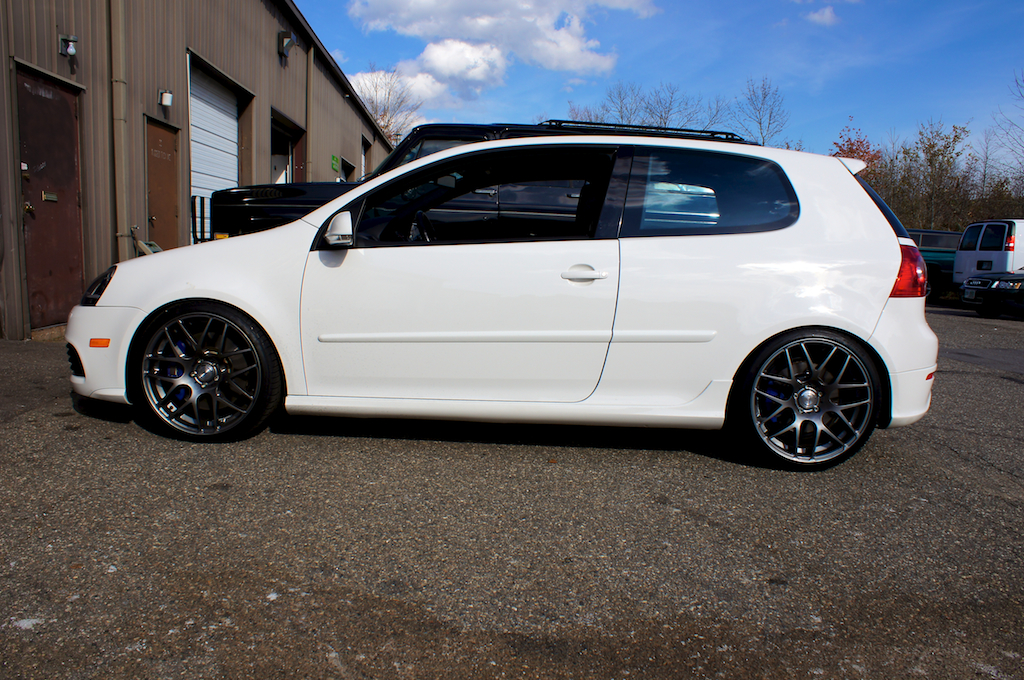

    Word go out about the car and an online blog / magazine picked it up and did a feature. The whole article can be read here. Otherwise, here's a few pics:
    Now that this project is done, I'm ready for something new. Hence my signature. Car ADD to the max.
