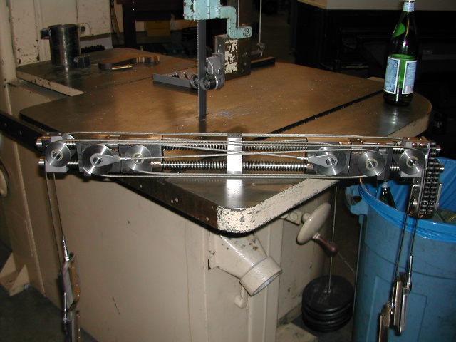

    Thanks for the compliment. The grills actually hang on aircraft cable.
    This is inside the top cross tube:
    I had to think about this one for a bit.
    Thanks again,
    Phil

    that pulley system (you came up with that?) is pretty damn awesome!!!

    Can the top grill go all the way down to the bottom one? I'm thinking bbq paninis!

    Hi ChumpChange,
    The grills stop within 4 inches of each other no matter where they are in elevation. However that's not a bad idea. It would be matter of mounting the grills off center on the lift plates. You have to be careful when you build stuff and hand it to people. If you give them too many options they can get into trouble. I just made it so you couldn't crash the grills and lock up the lift mechanism.
